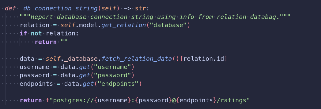

A: Yes, the library is available: data-platform-libs. The integration is trivial: example. - Q: How do I obtain the database url/uri?
A: it is planned, but currently missing. Meanwhile use this example, or follow:
