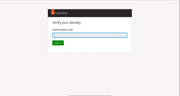

Once the password is set, you will then be prompted to configure 2FA (mandatory).

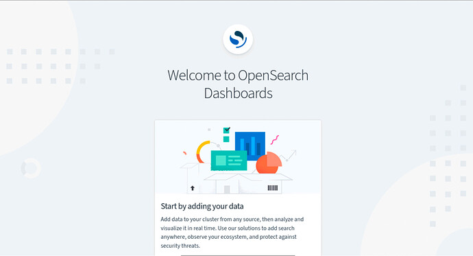

Access Opensearch Dashboards Using Single Sign In
To access OpenSearch Dashboards, use the IP address on the opensearch-dashboards/0 unit to form the link https://{ip-address}:5601.

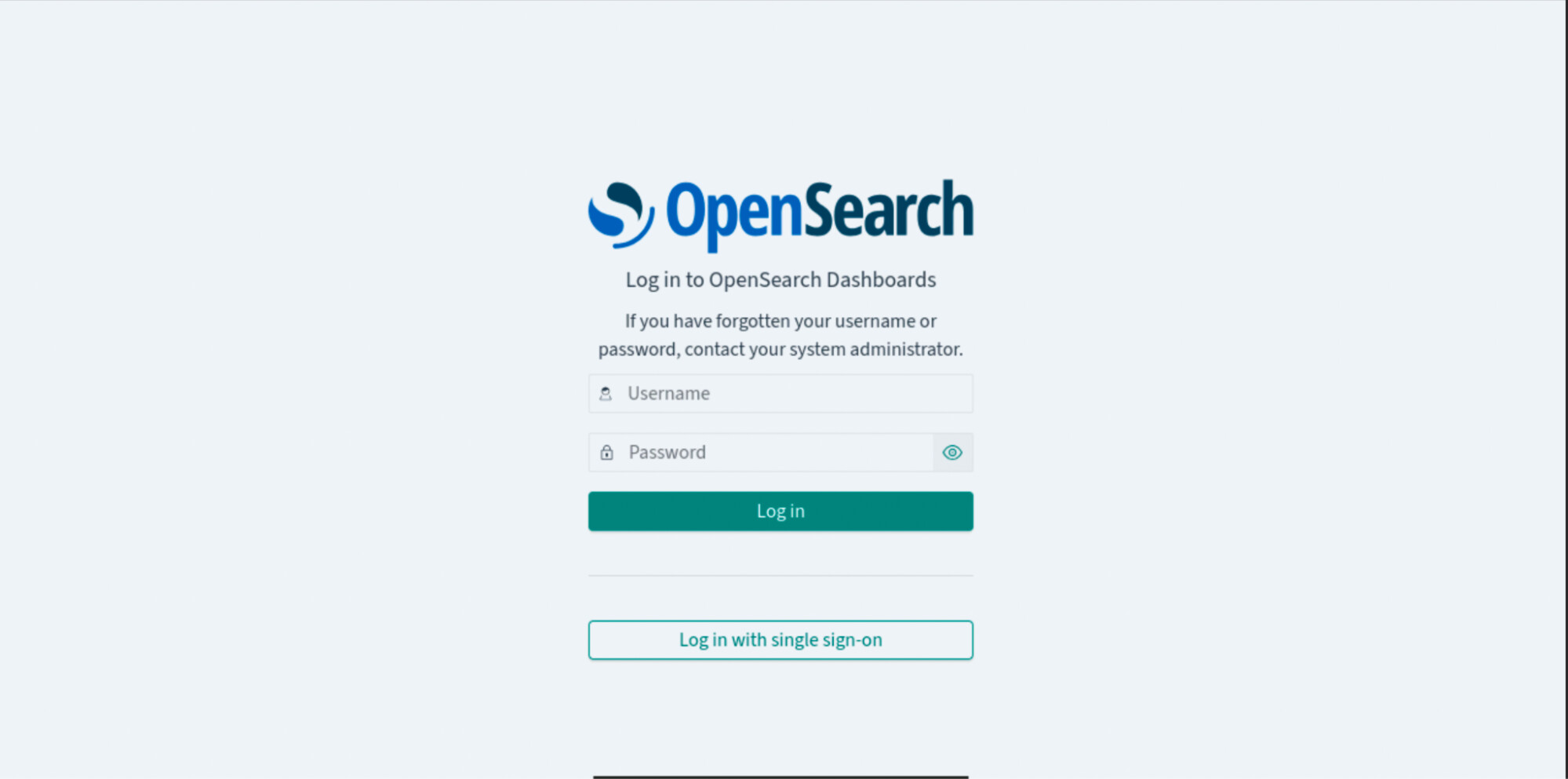

Once the account is ready, open OpenSearch Dashboards. A Log in with single sign-on button will appear.

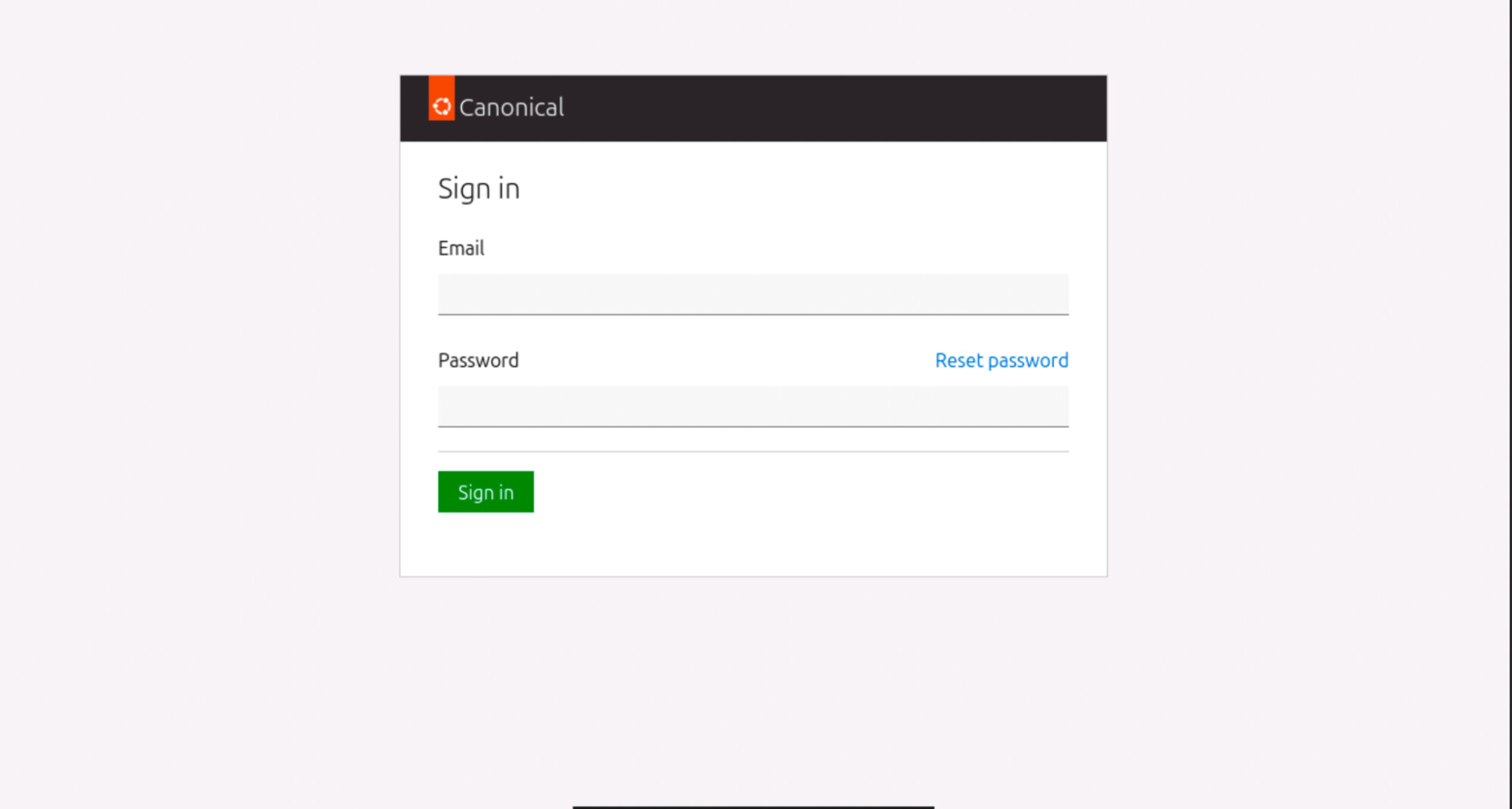

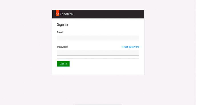

Click the button to open the identity platform login UI. You will get redirected to the identity platform UI login screen where you will be prompted to enter the email and password.

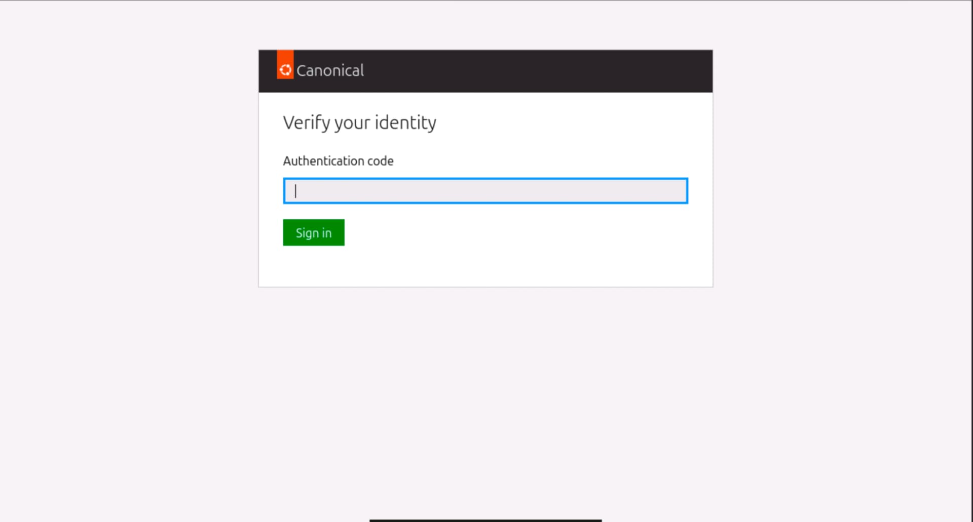

If it is your first time connecting, it will also ask for the 2FA code.

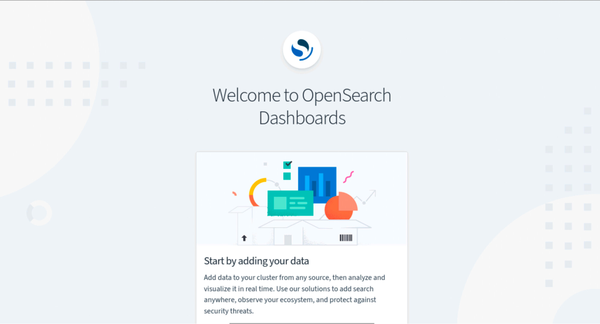

After a successful login, you will be redirected to the OpenSearch Dashboards home screen.
