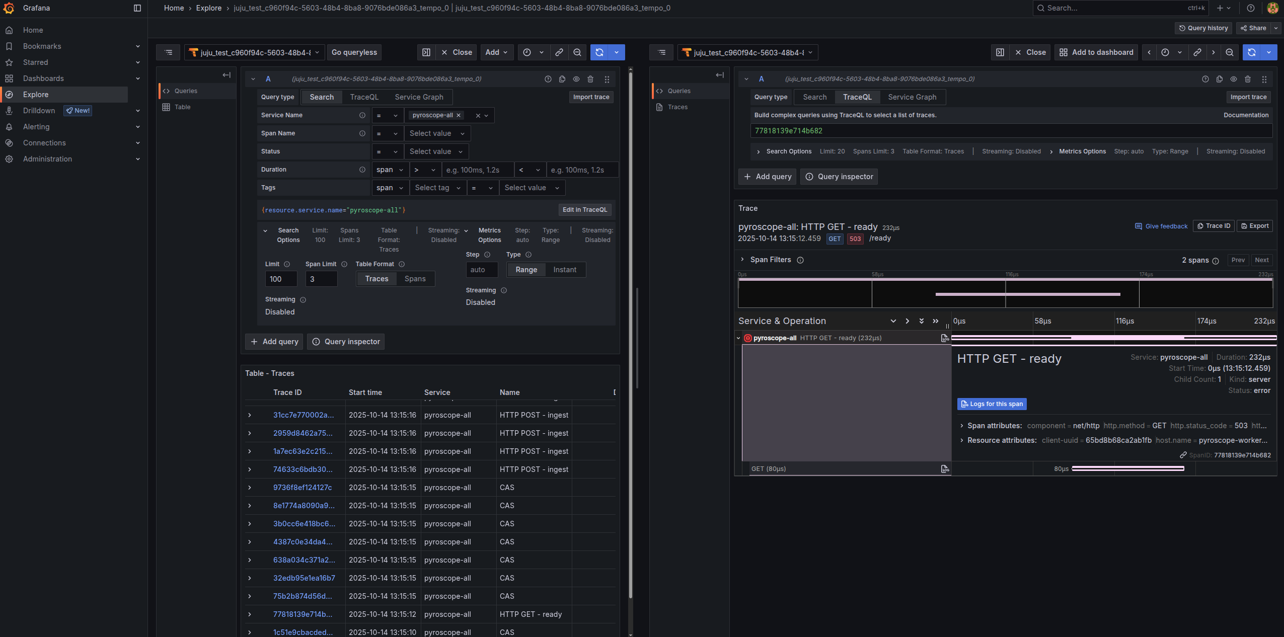

Open the Grafana web UI from your local web browser and login using the admin password.
Then, go to Toggle Menu → Explore → select your Tempo datasource → Add filters to view traces from your charmed workload → Run query
When you expand a trace, you’ll see a link icon next to each span that lets you jump directly to the logs related to that span, as shown in the figure below.

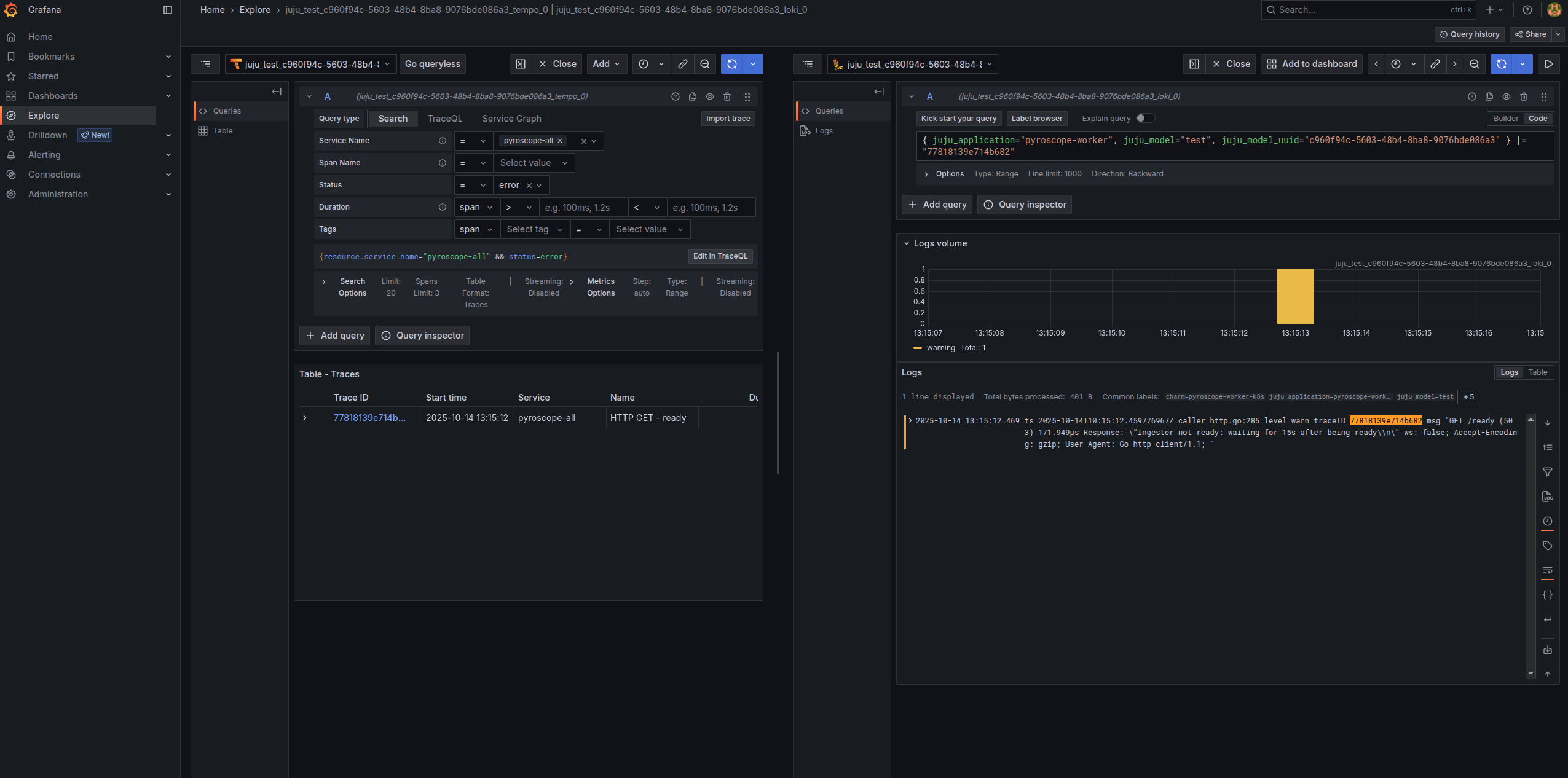

If the span has corresponding logs, clicking Logs for this span will take you to a view that queries and displays those logs, as shown below.
