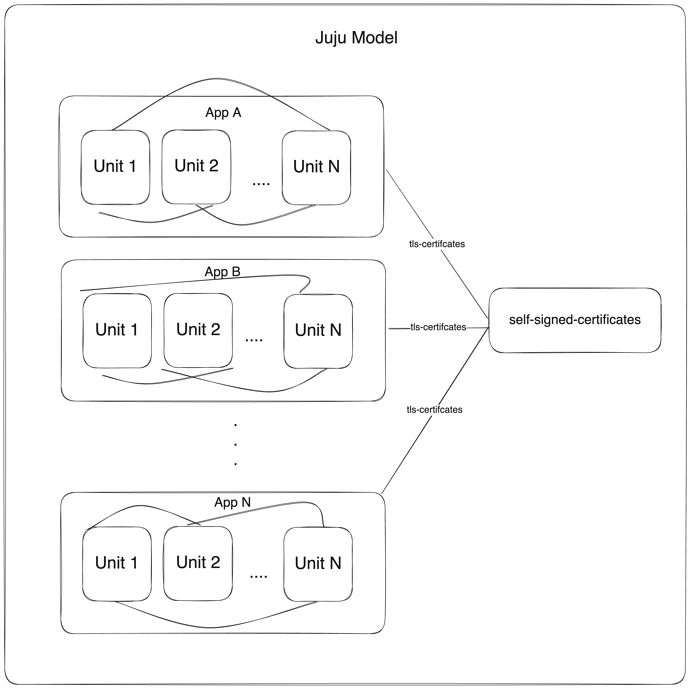

Secure Internal Communication of a Charm
When deploying multiple applications in a Juju model that require TLS for internal communication (e.g., between the units of the same application), we recommend using the self-signed-certificates charm.
Integrate each application with self-signed-certificates over the tls-certificates interface in UNIT mode. This ensures that each unit receives its own unique certificate.
The self-signed-certificates charm will issue a Certificate object for each unit, containing:
  • Signed leaf certificate for that specific unit.
  • CA certificate that signed the leaf certificate.
  • Certificate chain in the form: [Signed Leaf Certificate, CA Certificate].
Trust Establishment
Because the CA is self-signed, it is not trusted by default by most systems.
To establish trust:
  • Explicitly configure the application to trust the CA certificate provided by self-signed-certificates.
  • Since the CA directly issues the unit certificates, trusting this CA is sufficient to validate the leaf certificates.
Each application can then configure TLS according to its own requirements, using the provided certificate, CA, and chain.
