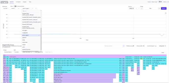

Then, in your local browser, open Parca UI on $PARCA_IP:7070
You should see an output similar to the one below, where you can find profiles for all processes running on the machine:
