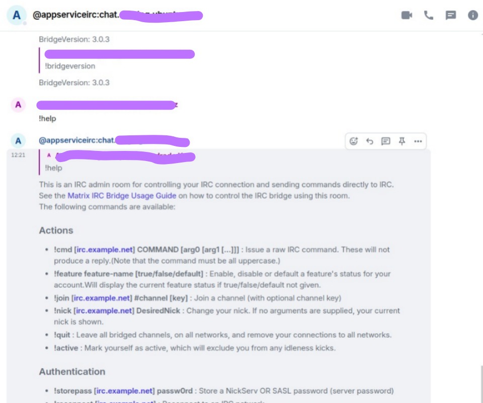

To interact with the Bridge, you can invite the user ircappservice to a room or sent a message.
Send a message to the user ircappservice. If a warning shows up, ignore and proceed.
The Bridge will show a help menu with all the options available. Try the following to guarantee that the bridge is working.
!bridgeversion
To check all available options, send the following command:
!help
Screenshot example:
