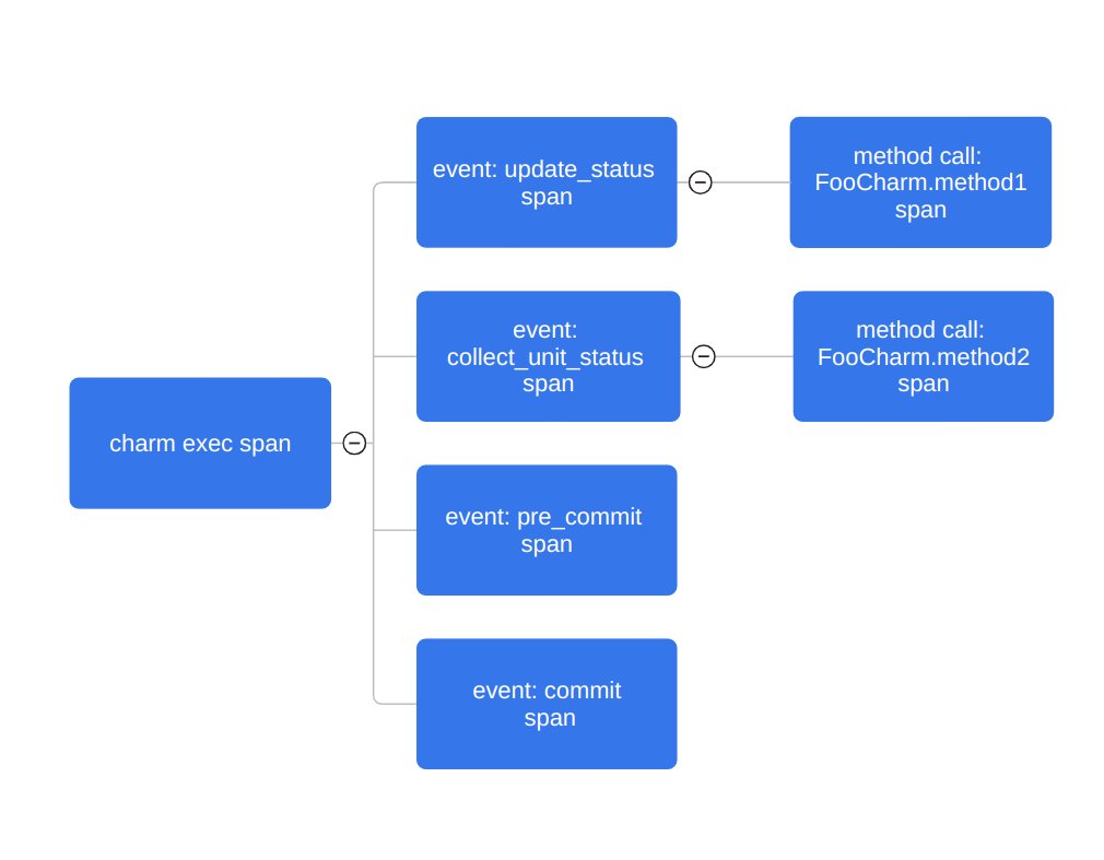

When the periodical update_status hook fires, by the end of your charm execution for this hook, an example execution flow can look like the below:
you’ll have a trace created in your tempo backend with a similar structure to the below:
