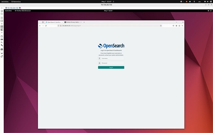

Assuming that you have a virtual environment available (as described in Step 1.Set up a virtual environment, open a browser and type there the following URL:
http://<dashboards_juju_public_address>:5601
The address of the unit is available in the juju status output of the opensearch-dashboards unit. For example, in the output from Step 2. Deploy, this would be 10.163.9.173.
You should see something like this:

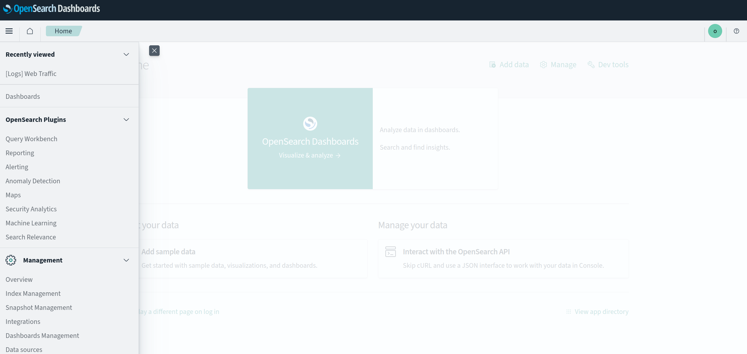

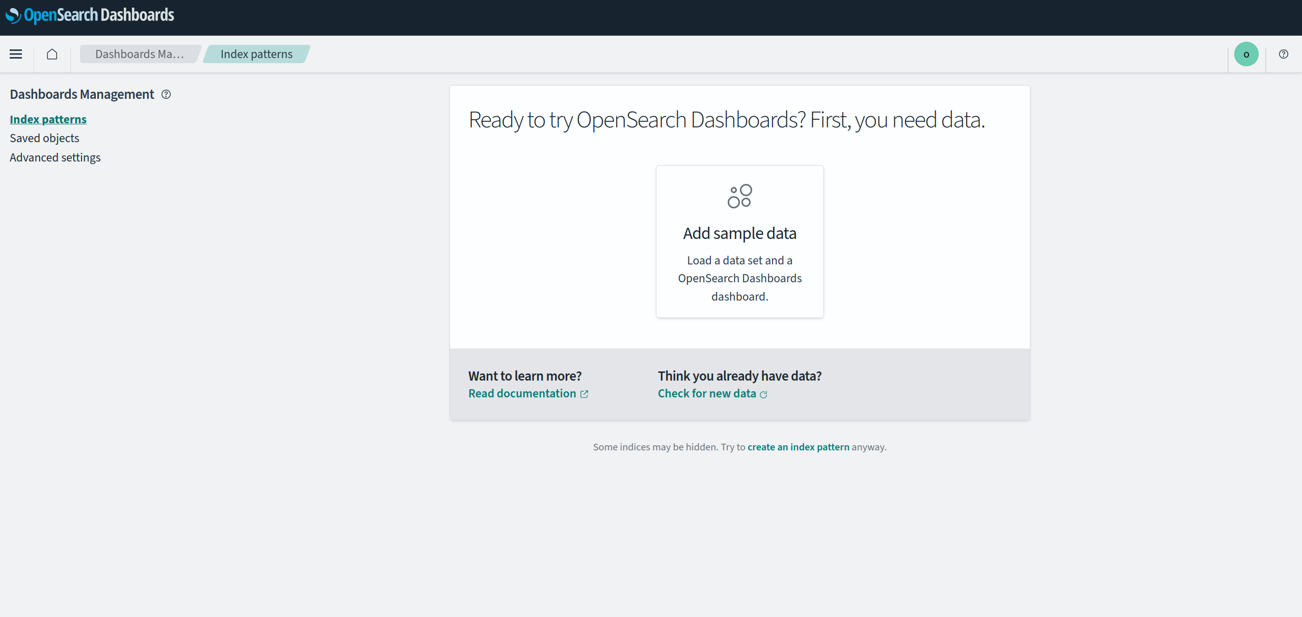

Log in to the Dashboard using these credentials. Clicking the top left icon the main menu will pull down. Select Management / Dashboards Management here

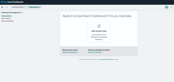

Select Index patterns on the next view:

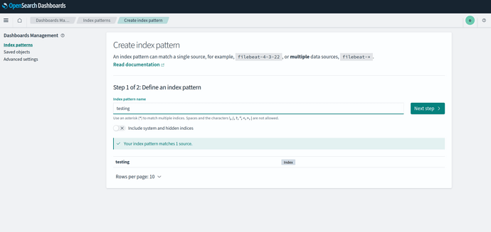

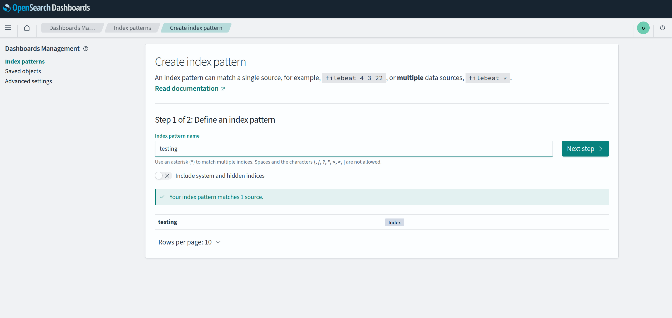

Click on create index pattern at the bottom.
Adding the index name that used for data-integrator deployment (in our example: testing) as an index pattern enables Dashboard access to the user’s Opensearch space.
Click on the Next step button, and finalize the index pattern creation.
As a verification, the user’s index metadata will display.

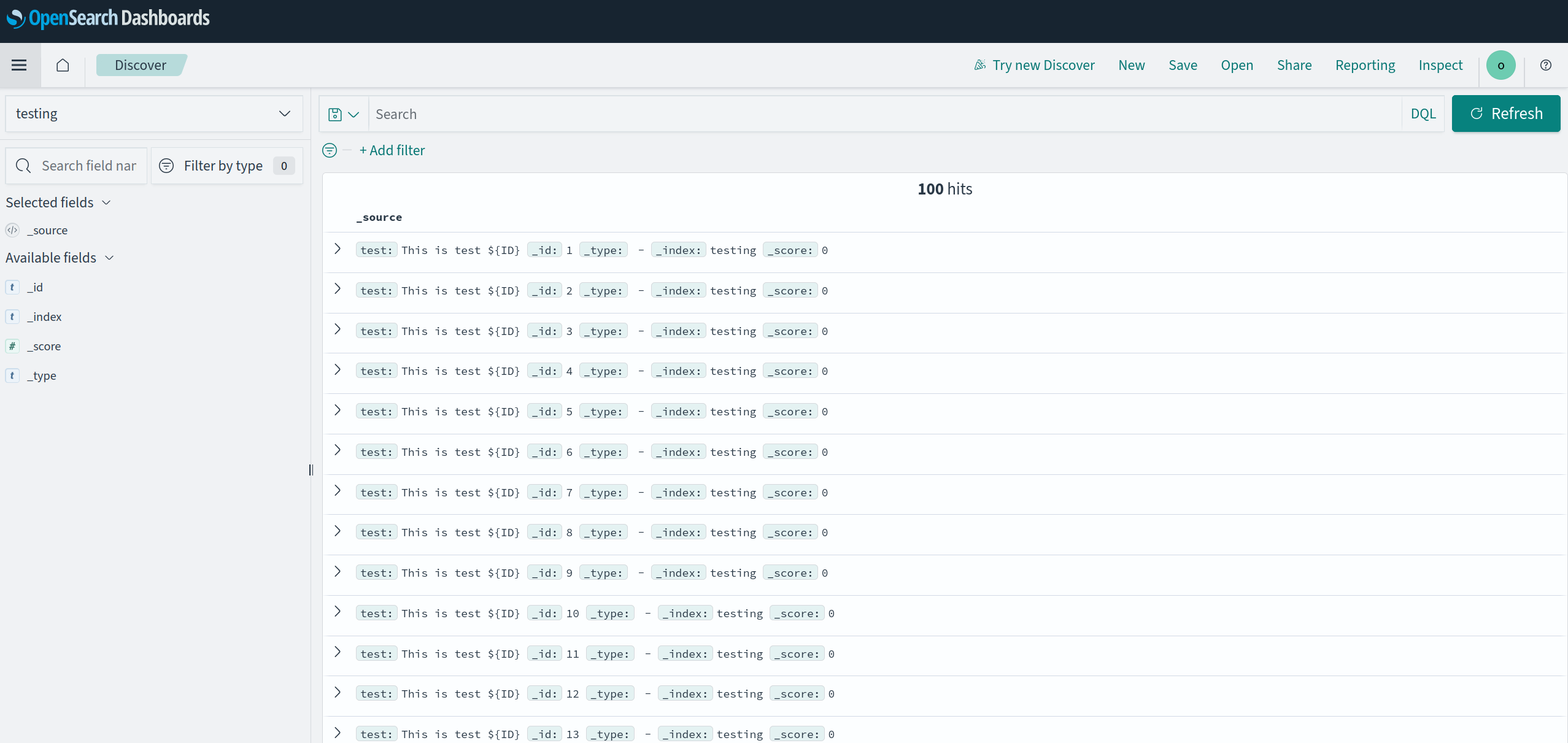

Add and visualize data
For test purposes, a simple method could do. Like generating data from the command-line, via the Opensearch API:
for ID in `seq 1 100`
do
curl -sk -u opensearch-client_15:8kubD7nbWYZFHPVEzIVmTyqV42I7wHb4 \
-XPUT https://10.4.151.211:9200/testing/_doc/${ID} \
-H "Content-Type: application/json" \
-d '{"test": "This is test ${ID}"}'
done

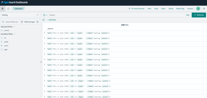

This is how raw data gets displayed in the Dashboard

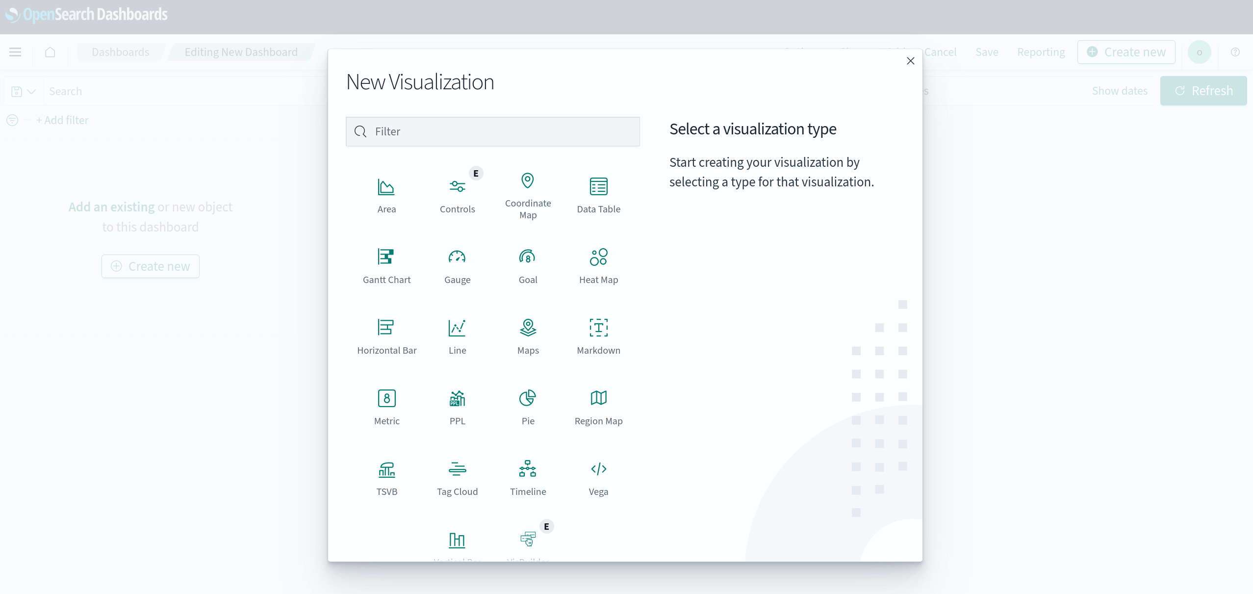

Data Visualization
Opensearch Dashboards offers a variety of diagrams and data displays.
Choose Dashboards in the main left-side menu, and you will be presented to the selection:
