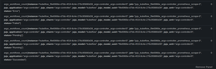

Prometheus metrics
Navigate to the Prometheus URL (see Get COS URLs for more details).
To view the metrics for a specific charm, query {juju_application="<app-name>"}.
For example, you can check the argo-controller logs using this query:
argo_workflows_count{juju_model="kubeflow", juju_charm="argo-controller"}
It returns all the charm-related metrics:
To view all the metrics available from Prometheus, use the metrics explorer by clicking on the round icon next to Execute in that query form.
See Prometheus metrics for more details on available metrics.

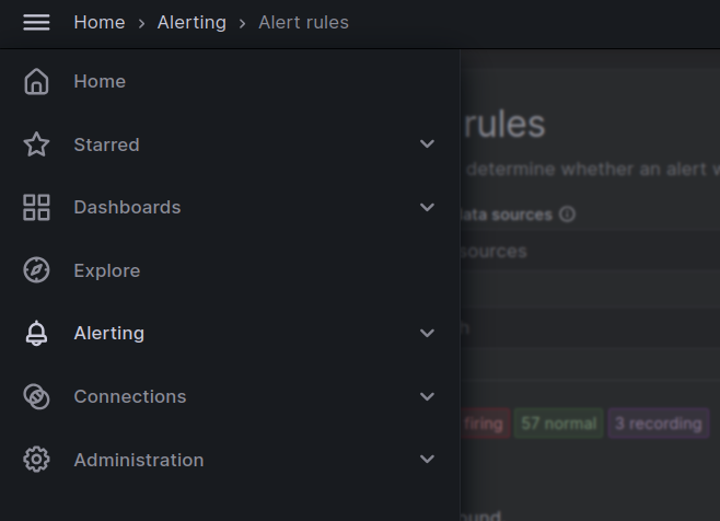

Prometheus alerts
Navigate to the Prometheus URL and click on Alerting under the left-hand side navigation bar. This shows all available alerts.
You can filter from Active, Pending and Firing alerts using the available checkboxes.
To view alerts for a specific charm, type its name in the search bar on the top.
See Prometheus alerts for more details.

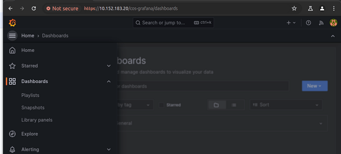

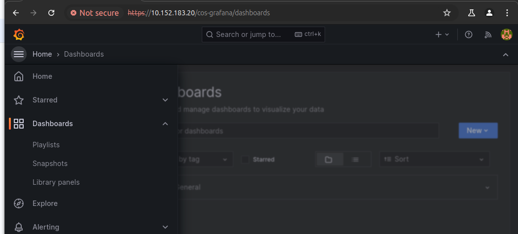

Grafana dashboards
Navigate to the Grafana dashboard URL (see Get COS URLs for more details). Get the admin password:
juju run -m cos-controller:cos grafana/leader get-admin-password
Using admin as the username, log in with the password returned. See the available dashboards by clicking on Dashboards in the sidebar menu:
See Grafana dashboards for more information.

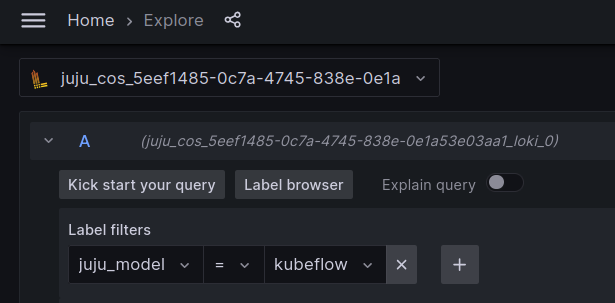

Loki logs
Loki does not provide a UI. You can use the Grafana UI for checking Loki logs.
Navigate to the Grafana URL and click on Explore, where you can navigate through all collected logs by selecting Loki as source.
See Visualize log data for more details on navigating Grafana Loki. For more information on forwarded logs, see Loki logs.
